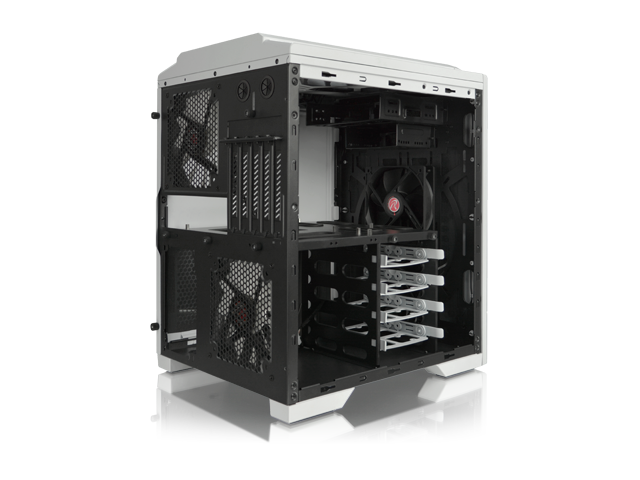

I'm getting a new case for this motherboard. Hopefully they ship me a brand new MB anyway. This is the new case I ordered,
I only have 3 system fan headers on my motherboard. I'm gonna be using a for the rear fan. The case comes with two rear 140mm fans. The bottom one looks like it would draw air out over any mechanical HDD or anything in the internal 3.5 or 2.5 bays. Since nothing will be going in those bays it makes sense to only install a top one really. For the front I don't believe I'll really need a fan. However I do have a which I can use for the front top one. I can remove the bottom front one. That way the air intake from the front will blow over the motherboard and out the back 140mm fan. I've also got the cpu fan which will blow air out the back.
will be my new cpu cooler.
I won't be using the fans the come with it since they are only supposedly 2 pin fans. I'd rather take advantage of PWM.

Think I might get two of the fans. Either way I can only connect up to 3 fans to motherboard PWM 4 pin connections which I'd rather take advantage of then use the 2 pin fans that these cases come with. So I'd remove the bottom 120mm in the front, remove the top 120mm in front and replace it with the . I think that would work out well anyway. Of course the two 140mm would be in the back.
Any comments on this Scott?

If I wasn't going to fill the drive bays or slots I'd probably just use a single 140mm rear fan. I value a quiet system and too many fans are unnecessary and noisy. Scott.

Makes sense Scott. I don't think I'll ever fill the drive bays with anything anyway. Thanks!.
