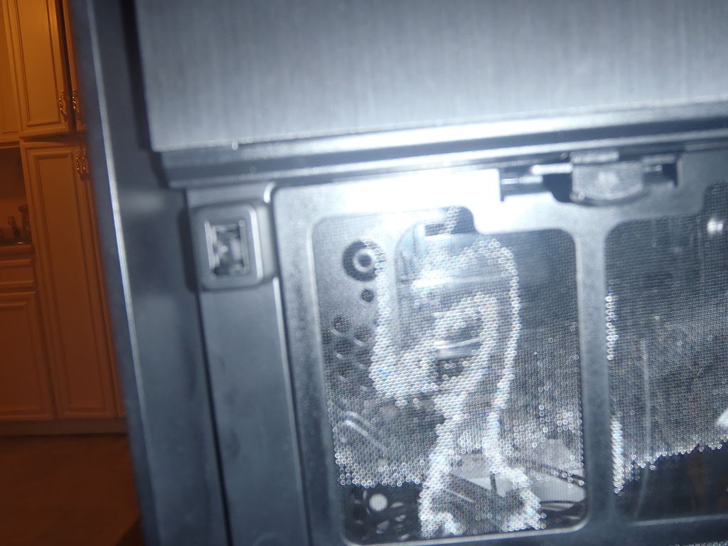

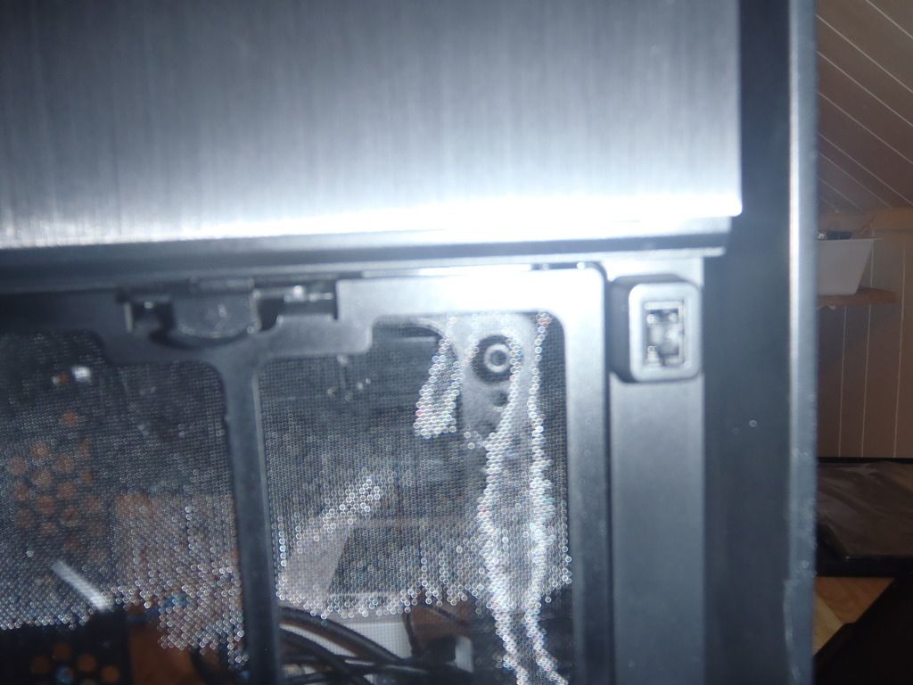

Here is a different case that looks better in my opinion to the other one. With this one I can at least have an Optical drive or two installed.
This case is great but I don't like the fact that it has top vents and there is no filter to put over these vents. I'd think a filter would be important, unless you want things falling into your case while you are working. Not sure how that would happen, but I see it as a reasonably possibility that you could accidentally knock something off your desk and it could fall into your case while the pc is up and running. That could be a problem.

Alright then. What do you think about the fact that there is very little clearance between the rear fan and the actual CPU fan. Like I say about 2 inches. I would have to guess that whatever the cpu fan blows down, the rear fan would just be pulling out. I will get a picture for you.
Top
 Profile
Reply with quote
 Post subject: Re: New PC Build
 Post Posted: Sat Apr 22, 2017 4:19 pm
Offline
Joined: Tue May 08, 2007 8:54 pm
Posts: 1822
A few.
Top
 Profile
Reply with quote
 Post Posted: Sat Apr 22, 2017 4:30 pm
Offline
Posts: 1822
See what I mean Scott?

I also believe the front panel "notches" are broken. It still holds but is easily knocked over and open. There is a little panel that you are able to take off and that's what falls easily. I'm gonna see if I can just purchase a front panel replace instead of RMAing the entire case.

The clearance seems fine. I would run both of the fans at lower speeds. Scott.

I took a picture of the front panel where the audio connects. I can not see any type of damage or anything so I doubt they would replace it for free. I still think it's a software problem.
